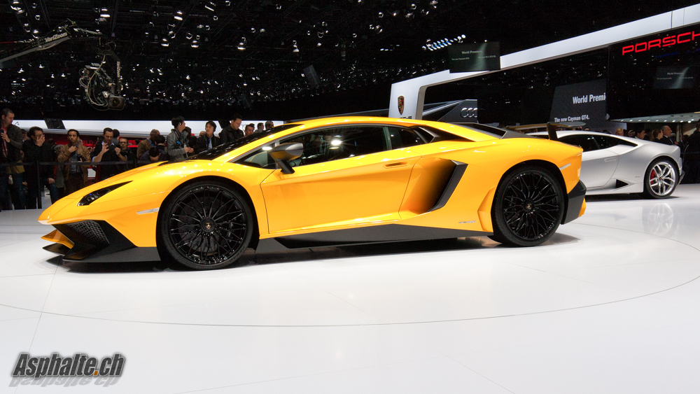

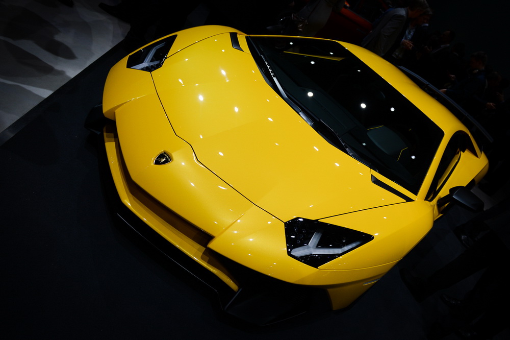

Geneva 2015: Lamborghini Aventador LP750-4 Superveloce
Inside, the instrument panel is new: a TFT LCD wih yellow background features a large rev counter, blue shift lights and a lateral G indicator.
The launch color is a new specific tint, Rosso Bia, with an alcantara interior. Price is set at 327,190.00 Euro without tax. The commercial launch will take place in spring 2015.

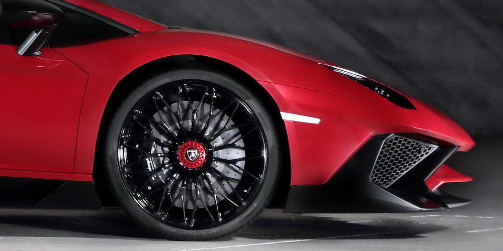

| Brakes | Dual hydraulic circuit brake system with vacuum brake booster; front and rear CCB, (6-cylinder brake callipers, 4-cylinder brake callipers) |
| Ventilated discs (front – rear) | Ø 400 x 38 mm – Ø 380 x 38 mm |
| Steering | Steering Gear with 3 different servotronic characteristics coupled with Lamborghini dynamic steering (LDS), managed by drive select mode |
| Tires (front – rear) | Pirelli P0 Corsa 255/35 ZR20 – 355/25 ZR21 |
| Wheels (front – rear) | 9”JX20” H2 ET 32.2 – 13” JX21”H2 ET 66.7 |
