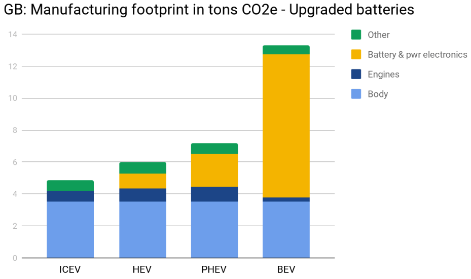

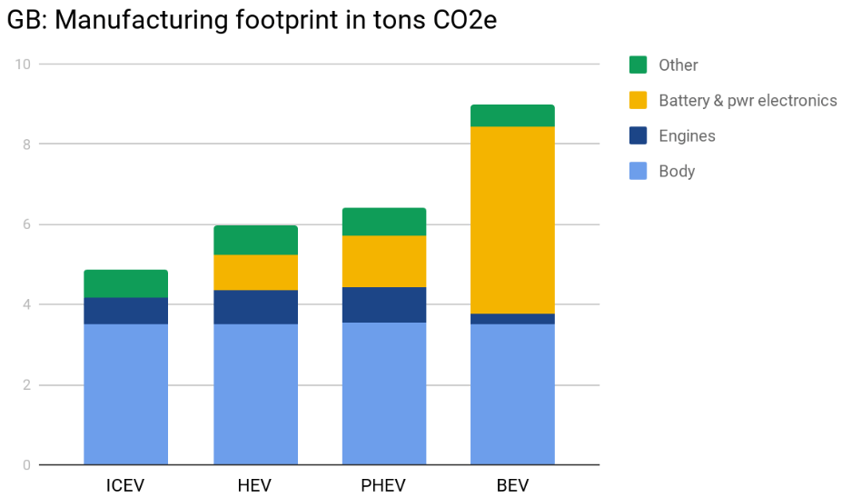

The british study estimates the CO2e footprint related to the manufacturing of the different vehicle categories, often called grey energy:
Updated for contemporary models with an electric range more acceptable to consumers i.e. doubled, the difference in the manufacturing footprint becomes more stark.
The manufacturing footprint estimate in this study suggests the following comments:
– the place of manufacturing and related energy source(s) assumed are not clearly documented while they should play a prominent role in the footprint of the supply chain
– recycling of the battery pack at vehicle end of life, for instance for grid storage, if it eventually becomes scalable

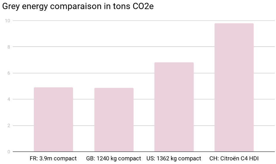

The grey energy embedded in the diesel and petrol cars are comparable to the british study, but the assessment of the electric car – though identical in its definition – is 23% lower.

With 8.8 tons of CO2e for the same Nissan Leaf, the american model estimates the manufacturing footprint at 9 tons, a level comparable with the british study, but 28% higher than the french study. The Tesla Model S 85 kWh is estimated at 15.2 tons of CO2e, including 5.4 tons for the battery pack.

These factors amplify the footprint estimate of all internal combustion cars: with 32 to 40 tons of CO2e, compact diesel cars are estimated 1.5 to 2x higher than in the french study. The swiss study also reaches a strikingly higher manufacturing footprint than the three other papers.
