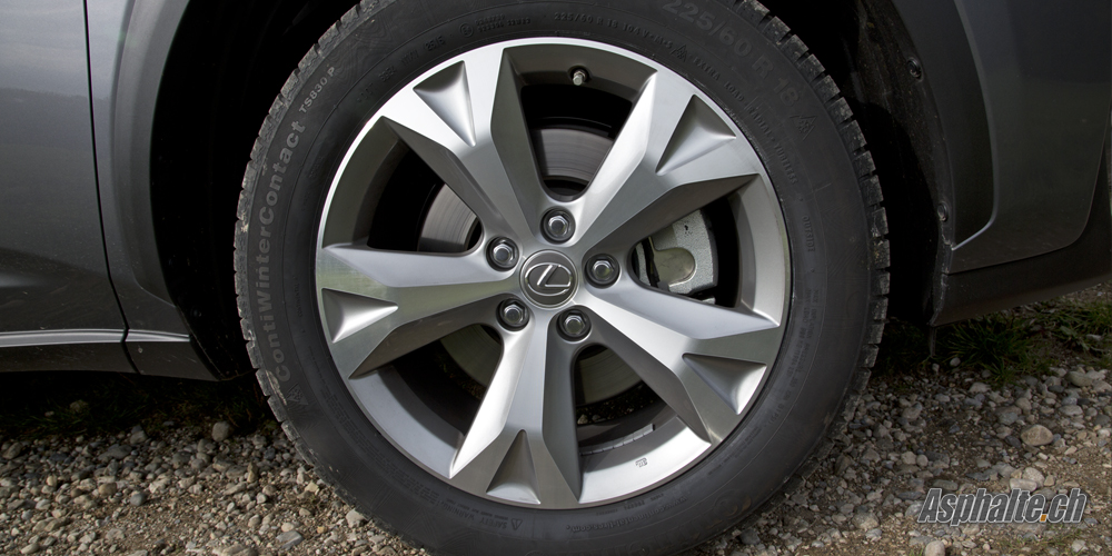

| Pneumatiques AV | 225/65R17 | 225/55R18 | 225/60 R17 |
| Pneumatiques AR | 225/65R17 | 225/55R18 | 225/60 R17 |
