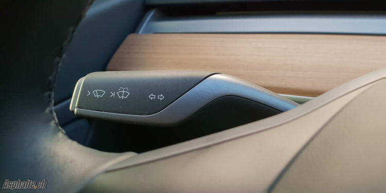

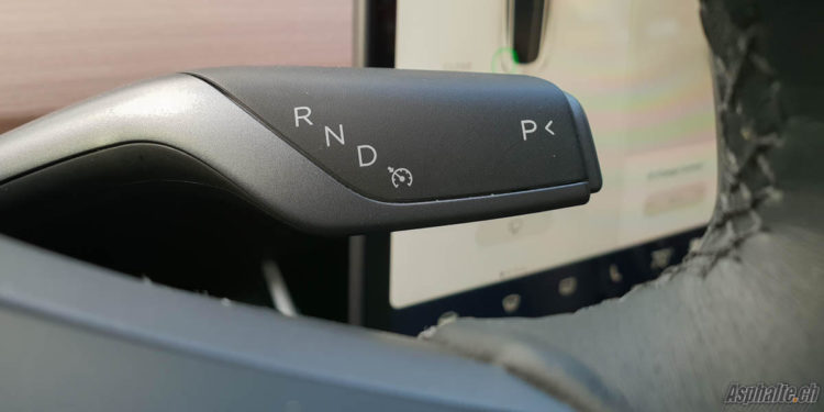

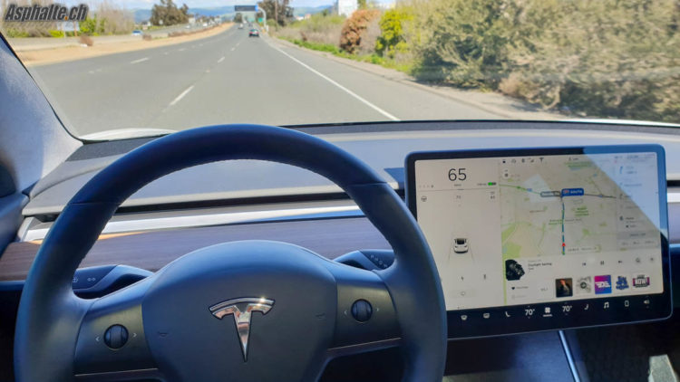

I made the mistake not to accustom myself with the location of the basic functions of 15″ touch screen and find myself trapped with a light drizzle that scatters light on the windscreen and no clue where the windshield wiper function is located. Blinkers on the left, drive selector on the right, I find salvation in the windshield washer button. I will discover later that the windshield menu can be accessed through a few lateral swipes of the bottom left widget of the multifunction screen. Conventional buttons and switches can have their charm under certain circumstances.

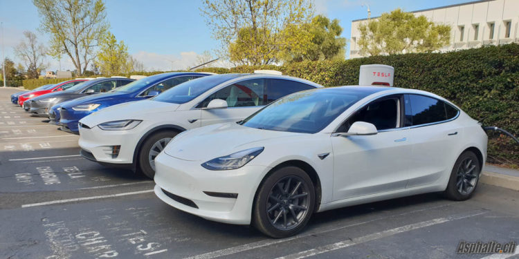

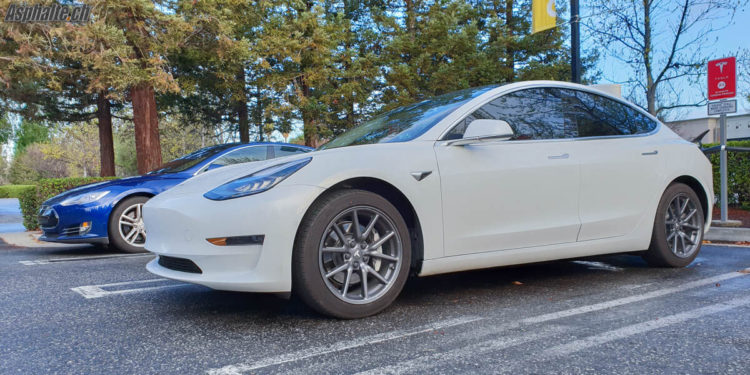

The next morning, I head straight for the nearest supercharger station in Mountain View. Installed in an office building neighbourhood, the station is surprisingly busy on this sunday early morning, with only two stalls out of twelve available. Model S and Model X owners are either trying to save a few bucks on their monthly electric bill, or do not have access to a plug, which is surprising for this affluent demographic in a largely single family home region.
Supercharing Model 3 is not free, i load up 128 miles of range (206 km) in 32 minutes at a cost of 7.80$, or 3.80$ for 100 km. Relatively cheap, even in a region where gas costs 90 cents per liter.

Use of the the large touchscreen becomes intuitive quite quickly but few functions are accessible without clicking, swiping and navigating sub-menus. While the cost reduction rationale is understandable, the ergonomy is more questionable. The graphical user interface is true to Tesla standards, with clean and smooth graphics, and the introduction of destinations in the navigation system very easy. Model 3 supports keyless access through a smartphone app, but we were forced to use the valet key, a frustrating smart card which require close proximity to the B pillar to open the door, and the center console to activate motion.

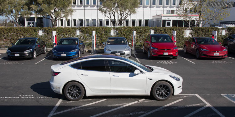

Our first pictures are securely stored on a flash card and we head to the mecca of the Musk fellowship, the former Toyota plant in Fremont, to top up our battery at the charging station. It is 9:50am on this sunny sunday morning and we have to queue to get a spot. Some are sleeping in their cars or catching up with email while their cars charge. We get another 84 km in 18 minutes for 3.12$. Charing power peaked only briefly at 63 kW, illustrating how charge current gets lower as the battery pack fills up.

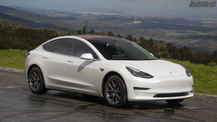

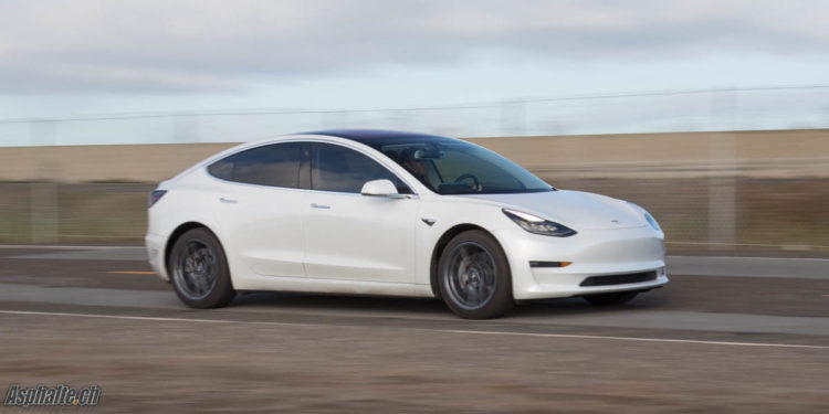

Next on the menu ? The twisties. We cross Dumbarton Bridge westward to hop on route 84 and climb toward Skyline Blvd, the backbone of the Peninsula’s twisty roads network where enthusiasts converge during week-ends. For the time being, Model 3 is rear wheel drive only, until D versions with twin motors can be announced and launched in production.
With a heavy right foot, the 235 mm wide Michelin tires are easily overwhelmed by the sudden surge of torque, provoking elusive bursts of wheel spin which are promptly tamed by electronics. Traction control cannot be switched off, and the Slip Start function, designed to cope with snowy or muddy conditions, does not seem to provide a solution to donut and burn-adicts.
Handling is far more convincing that with Model S. Unlike “D” Teslas, the front wheels do not receive any torque and only have to deal with directionality, making the front end sharper and less prone to understeer under acceleration. Combined with a relatively low weight (1730 kg claimed) and a low center of gravity, Model 3 is nimble and the pace at which it is capable to cover a winding road could surprise many. Abundant torque available instantly, and the possibility to apply it early from the apex make for an entertaining and effective cocktail. It is likely that the rather limited lateral support of the seats will prove to be a bigger limitation to your enjoyment than the dynamic abilities of the drive train, chassis or even the Michelin Primacy’s hard rubber,

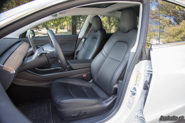

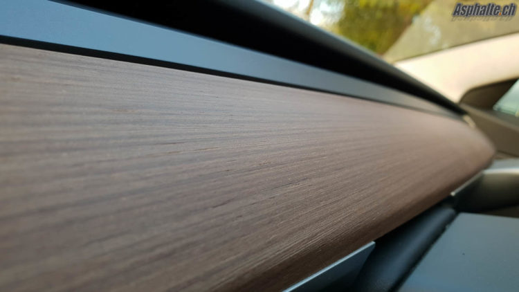

For this price range, perceived value is contrasted. The interior looks bare and austere. There is nothing except the steering wheel and this large 15″ slate, sturdily attached to the dashboard structure. The open pores wood trim (part of the 5000$ premium pack) is nicely executed, same for the alcantara roof liner and the faux-leather draping the seats.

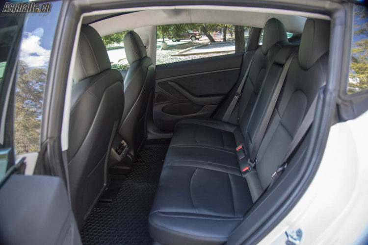

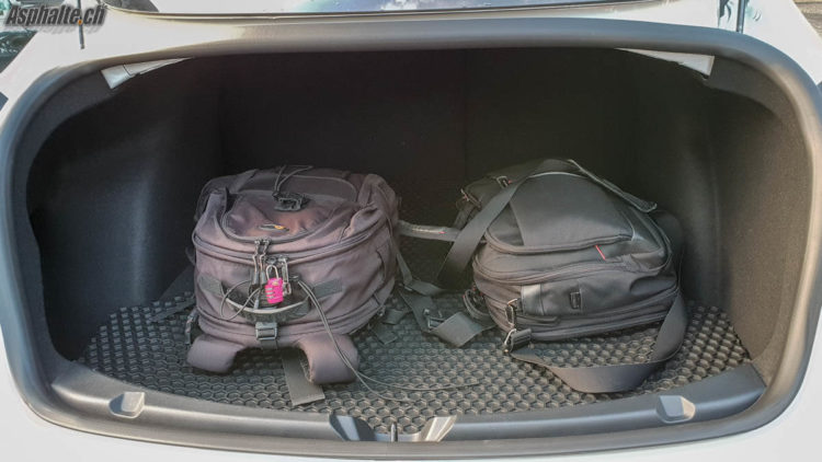

The center console pales in comparison and does not belong to a car of that price range, and the swivelling trap doors are flimsy. The rear seats are very low and, as with Model S, headroom is limited for an adult, and only viable with the glass panoramic roof. Leg room is good, subjectively more generous than in au Audi A4 for instance. Combined trunk capacity is specified at 424 liters, which makes for a rather small and narrow rear trunk.
