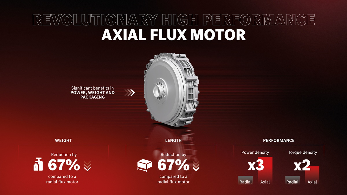

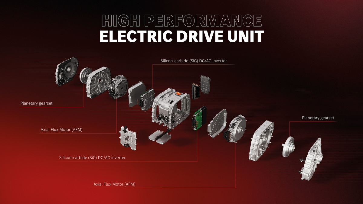

- The CONCEPT AMG GT XX features three revolutionary axial flux motors that together produce more than 1,000 kW (1,360 hp). That’s despite each one being around two-thirds smaller and lighter than a traditional electric motor. In fact, they are so compact that each motor would almost fit inside a pizza box.
- The electric motors are packaged into High Performance Electric Drive Units (HP.EDUs) front and rear, with one motor in the front drive unit and two in the rear. Each motor assembly features its own silicon-carbide DC/AC inverter. One of the hardest substances on earth – with an official rating just below diamonds –
silicon carbide is extremely tough and heat-resistant, which is why it’s also used in rocket engines and as protective armour on space telescopes.
- Copper coils are an integral part of an electric motor, but the key is to pack as much of the material as possible into a very tight space. That’s why the copper wire used in the innovative axial flux motor that powers the Concept AMG GT XX isn’t round, but rectangular. Think of it like pasta: when serving up a hearty Ragù, Italians swap spaghetti for tagliatelle, because its flatter, broader surface carries more of the sauce. The rectangle-shaped wire is then precisely bent and wound into a specific radius, allowing for more copper per slot in the stator. The result is better power density and thermal efficiency – and not a tomato-stained shirt in sight.

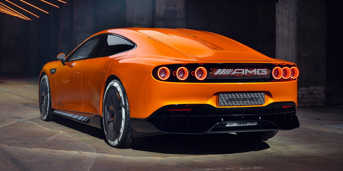

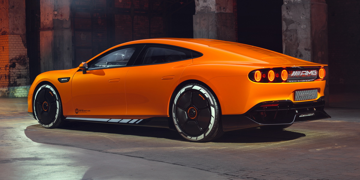

- The CONCEPT AMG GT XX has a drag coefficient of 0.198 – about the same as a soaring eagle. Very few things in nature have a more aerodynamic shape – except for a peregrine falcon in full dive mode or a dolphin at full speed. This slipstreamed design increases driving range while also maximising handling
stability in all areas up to a top speed of more than 360 km/h, without the need for active aero elements.

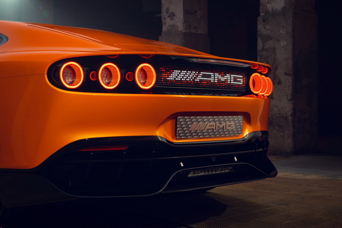

- It’s not just the headlights that shine – sections of the car’s bodywork also light up with the MBUX Fluid Light Paint. This electroluminescent technology works by applying a small current to electrically conductive paint layers. As well as producing a cool visual effect at night, this electric paint also signals when the car is slowing to a standstill, when it’s ready to charge and how far charging has progressed. Such paint’s properties also make it well suited to covert operations and it has even been used for experimental aircraft markings. Useful for slipping under the radar…

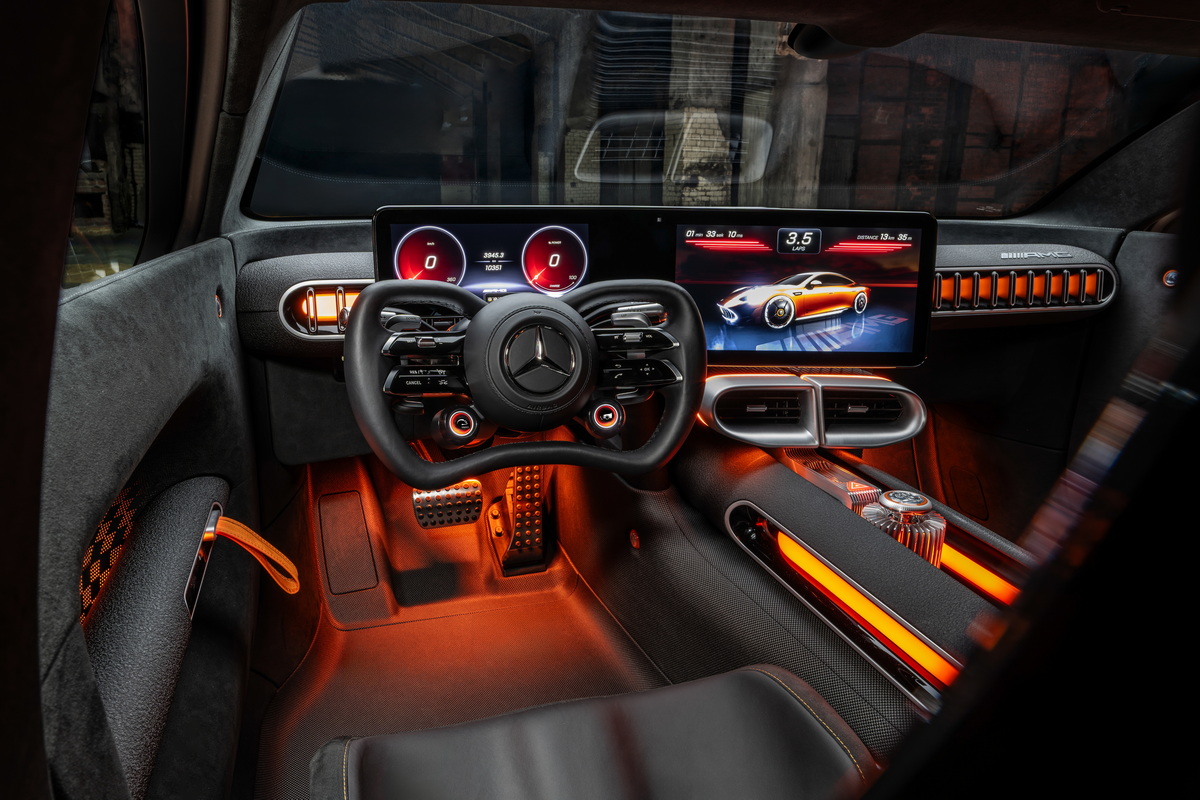

- For the first time in the automotive world, the CONCEPT AMG GT XX uses an innovative material called LABFIBER Biotech Leather Alternative. Produced with the latest biotechnology, it has the same look and feel as genuine leather yet it’s twice as strong and, with low thermal conductivity, it doesn’t heat up as
quickly – even in summer. Its clever combination of materials includes vegetable proteins, bio-based polymers and, best of all, a recycled AMG GT3 racing tyre. So our motorsport DNA doesn’t just put you inthe driver’s seat – it is the driver’s seat.
- The carbon-fibre front bucket seats feature ergonomic pads created using a 3D printing process and are tailored specifically to each driver. The idea comes from the racing world, where individual seat pads can be quickly swapped out for driver changes in endurance races. Every pad is finished with LABFIBER
Biotech Leather Alternative, which includes material from a recycled AMG GT3 tyre, meaning motorsport is literally part of the fabric of the car.

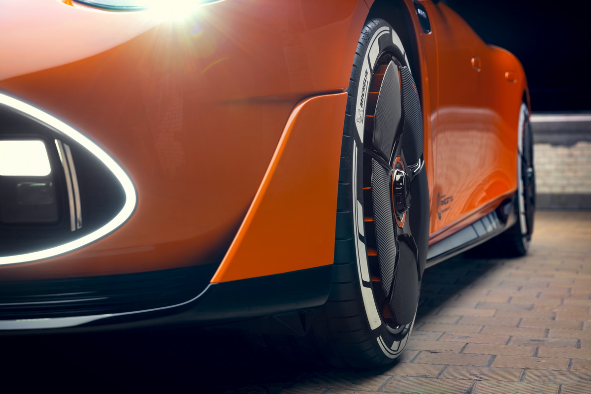

- In a patented world first, the CONCEPT AMG GT XX features wheels with active aero elements, providing the perfect answer to the conflict between brake cooling and aerodynamic efficiency. Each hub assembly has its own self-sufficient system comprising a generator, actuator and battery. When actuated, the
wheel’s five aeroblades create an opening around the edge of the rim and cooling air is pumped through to the brakes and back out again.
Electric motors Type Three axial flux motors
Max. drivetrain power kW (hp) >1,000 (>1,360)
